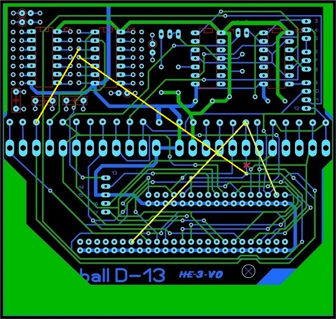

Ok, here is the mod for dual 2 sided drives.
The data separator unmodified, is set to run dual one sided drives with no modifications to it or the OSI controller.
For dual 2 sided drives we need to add a hex inverter in ic 3. and modify the D-13 and 610 or whichever OSI controller you are using.
Tested with a sony FRU 76H4091 1.44 floppy as drive A,C and a Shugart SA850 as drive B,D

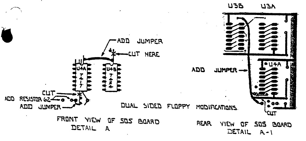

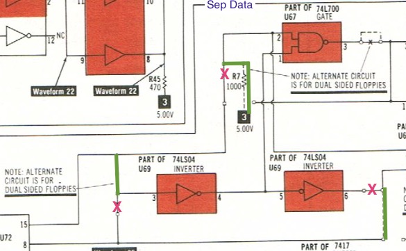

Re: Building the KLyball D-13
I have attempted to transfer the jumper settings for Dual Sided Drives on the 610 to the 505.
Here is what Klyball recommended for the 610: (3 cuts, 3 Jumpers) Here are my results: (3 cuts, 3 jumpers) /Jeff

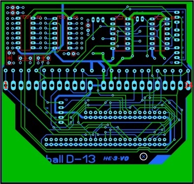

- Posts: 233
here is another view
