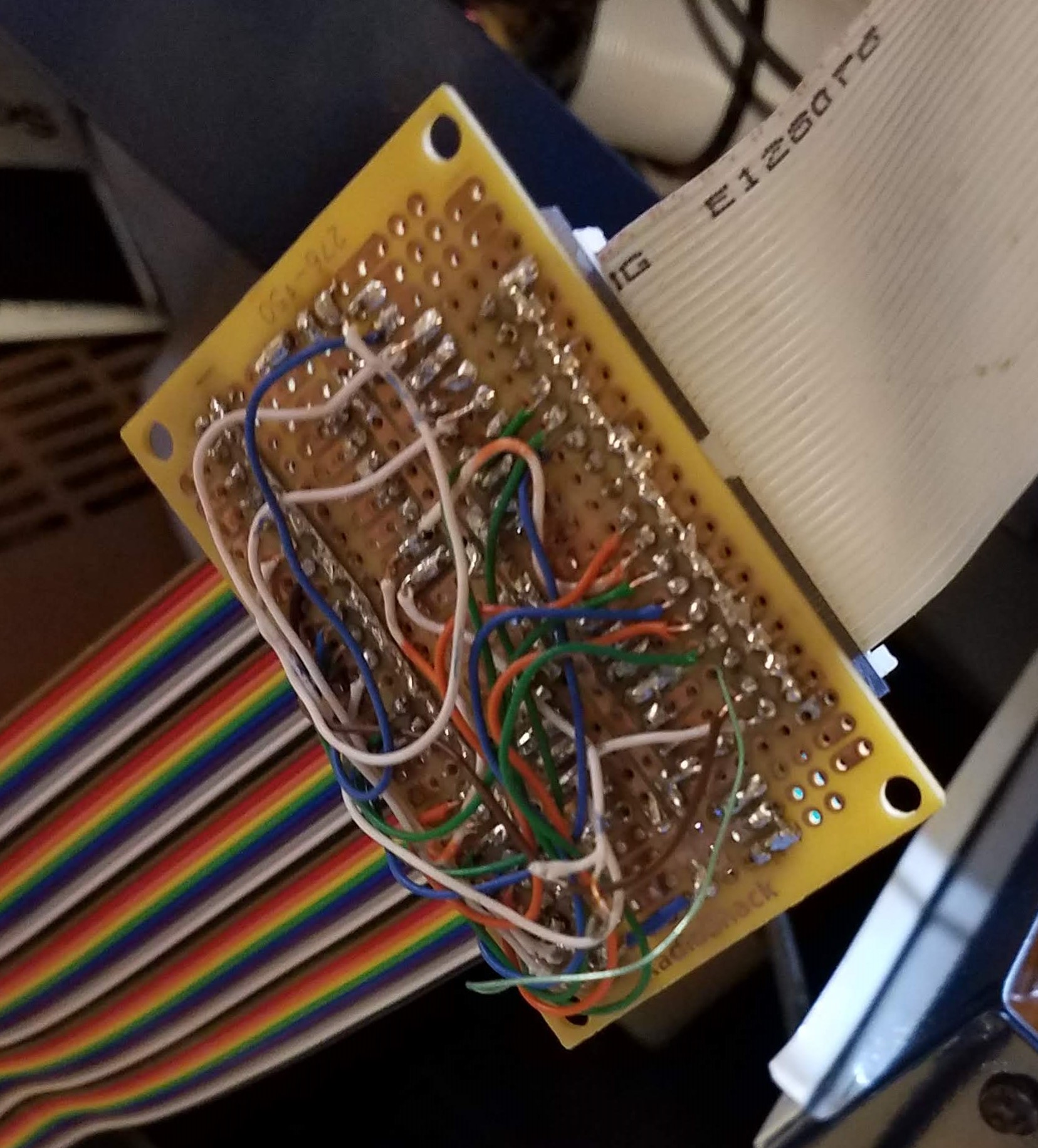

I am using a 470 card configured for eight inch single sided floppys.
You need to build or get a 50 pin to 34 pin drive adapter for use with an eight inch controller.
There is one on github that would work, part number FD50to34 but I just used the schematic on the webpage as a guide to make my own. I skipped all the motor control and drive select parts.
I used a radio shack P/N 2760150 proto-board which is $3.00 on Radio Shacks website..
I actually started to make my own data separator which didn't work, so I took out the chips and used it as an adapter. You just need one 50 pin socket and one 34 pin socket and about 15 or so jumper wires.

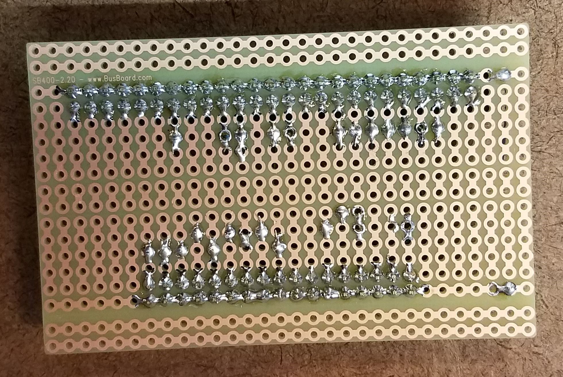

I made an improved 8" to 5 1/4" floppy adapter for the gotek.
I used a Busboard SB400 solderable breadboard from Jameco.
This board has the advantage that there are two extra buses on it that allow you to install the connector headers such that all the odd number pins are connected together and each of the even numbered pins has its own five hole pad to solder the jumpers.
It makes it very easy to build. Every pin and every jumper connection has a solder pad.
Make sure the odd pins are the ones connected together.
The row under the notch has the odd number pins.
There are only Thirteen wires to install.
First connect the ground pins on each connector together with a jumper.
Then install the rest of the jumpers.
50 Pin Conn 34 Pin Conn
46------------------------30
44------------------------28
42------------------------26
40------------------------24
38------------------------22
36------------------------20
34------------------------18
28------------------------12
26------------------------10
22------------------------34
20-------------------------8
14------------------------32
