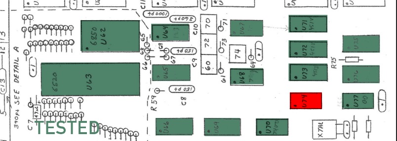

As nearly all the IC’s in the disk section of the D&N board are socketed, I next tried to shotgun replace some parts. Below you can see what parts I’ve replaced (in green) and what parts I haven’t because I don’t have spares in my parts bin. the problem still persists.
Disk section.jpg (150.74 KiB) Viewed 3667 times

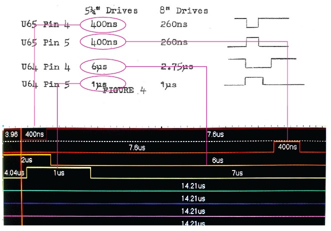

Finally I hooked up the analyser to the WRITE line, to try to get an idea as to what was happening when the 00’s are written. Again the analyser is probably not the best tool for this. What I saw was a little bit of fluctuation in the signal, but as I’m no pro, I really don’t know what I’m looking for, or even know if the reading from the analyser is accurate enough to draw any conclusions.
Here is a screen shots. It's magnified on a small area so you can see two negative pulses. I believe the pulses are supposed to be 400ns but you can see that the negative pulse, and the gap between pulses seems to fluctuate.
write 00's.jpg (52.11 KiB) Viewed 3667 times

Last update for tonight:
Now that I have discovered what seems to be a transient bit that seems to propagate through the data being written to the floppy, I thought this would be pretty easy to spot when probing the WRITE line with the analyser, so tonight I tried again.
I sent 00's to the floppy as before, and looked at what kind of signal was being sent through the WRITE line. I set the analyser at the highest frequency in the hopes that that would give me a more accurate measurement. I really couldn't see anything that looked like a cascading bit through the signal, Nothing obvious at all.
The only thing that looked a little odd was the 400ns pulse which fluctuated anywhere between 380ns to 420ns. Strangely enough they seemed (although I could be mistaken) to be in pairs. If there was a short pulse, then it was usually followed by a long pulse.
Tomorrow I'm going to try my second MPI drive and see if that exhibits the same symptoms when dumping the data back from the floppy.

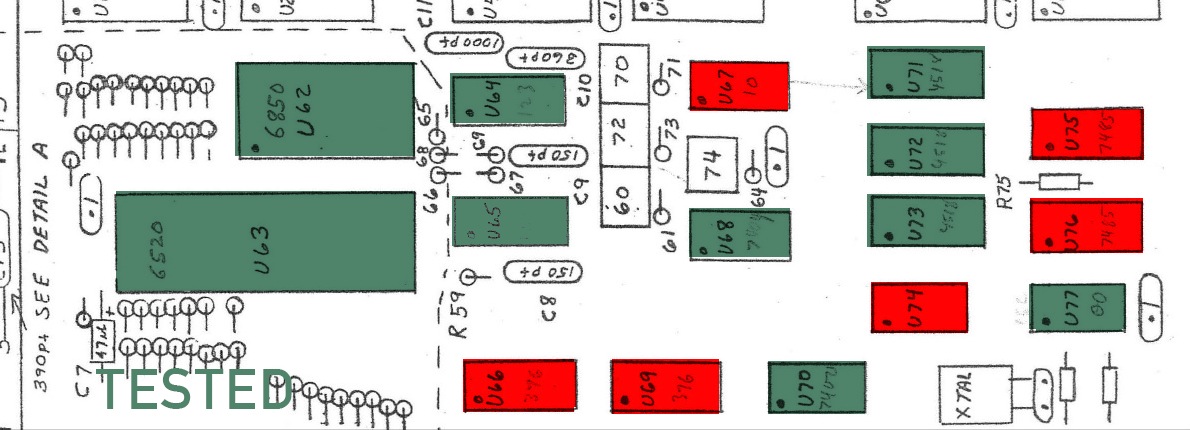

I have now changed out nearly every IC in the disk section of the D&N board. The only IC I haven't changed is the 74LS94 au U74 because it's the only one on the entire board that is soldered with no socket...and still I have the write issue!!!
replaced IC's.jpg (80.64 KiB) Viewed 3646 times
