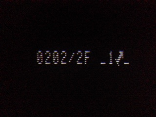

However the issue still persists starting $0200. Writing data starting at $0200 has various outcomes. Firstly there is some screen corruption with graphic characters appearing at the end of the instruction line and starting at $0202:
...and then the machine just freezes at around $021A. Reseting the machine and reading the bytes back show that some of the written bytes stick, but most don't. Common sense says this must be the second RAM chip in the first 2114 pair, however I've replaced both IC's with no change. Still scratching my head over the chips selects. Not sure if I'm just misunderstanding something here, but there certainly seems to be activity on /CS0 even though other /CS lines are active.

Ok, memory problem fixed.
Sorry for being such an idiot.
The problem was a dead 2114 on the D&N board.
Now I get the correct memory in BASIC (31999), and I also know that my memory program (that loads at $200) does not work on this system.
I ended up finding a memory test program in BASIC to find the bad IC...took a while for the program to go through all the addresses, but once it found the bad IC, it was an easy fix.
Again, sorry for being such a fool, and thanks for pointing me in the right direction, I could have been chasing this one for days.
