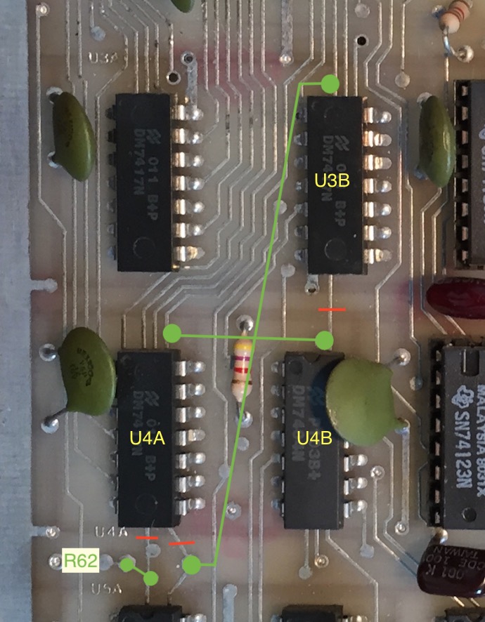

Here is a corrected diagram (I had 1 trace incorrect) for the Dual Sided Floppy Mod for the 505 board. I also placed all the jumpers and cuts on the component side.
Mods for Dual Sided Floppy 505 board.jpg (154.59 KiB) Viewed 3225 times
